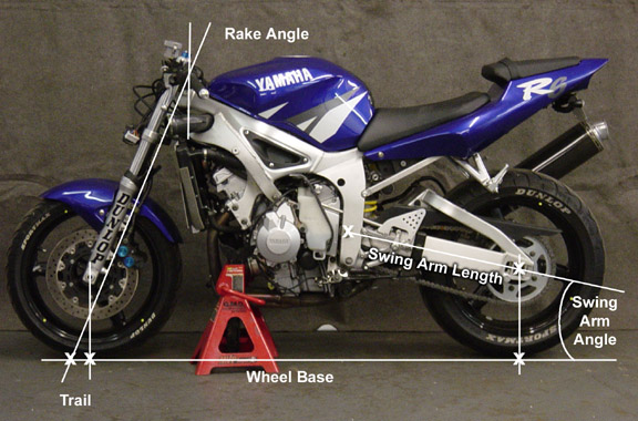

    So I've figured out that these numbers are important. Are these measurements taken when the bike is totally unweighted but tires still on the ground?
    Is swing arm angle the angle relative to horizontal of the swingarm pivot bolt to the rear axle?

    Here is a good pic for you Rob.
